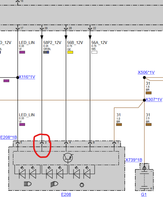

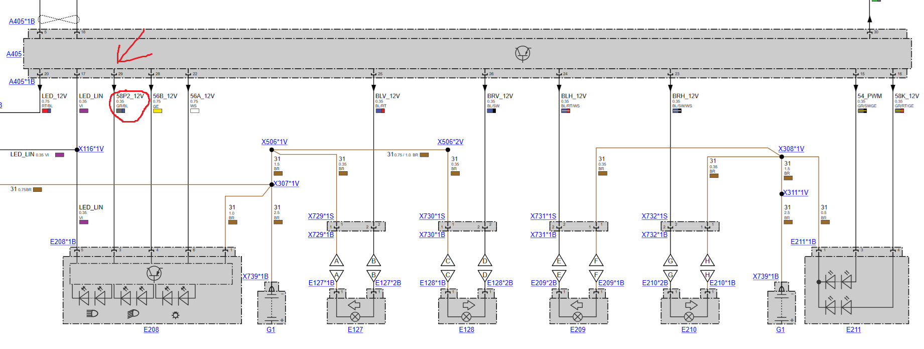

Ich habe es schon gemacht - ein Multifunkcion Blinker Retrofit fuer mein GS BJ2019. Nur ich habe jetzt gedenkt od dass Scheinwerfer wird arbeiten. Ich habe keine Fehler gemerkt und auch ISTA zeigt keine Fehler...

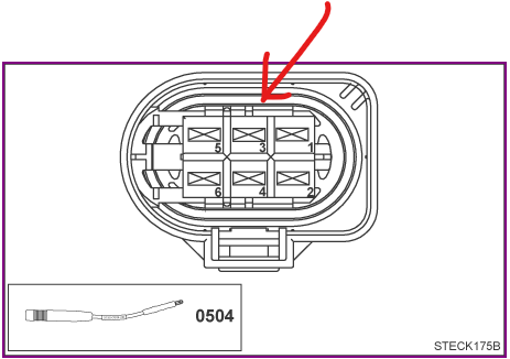

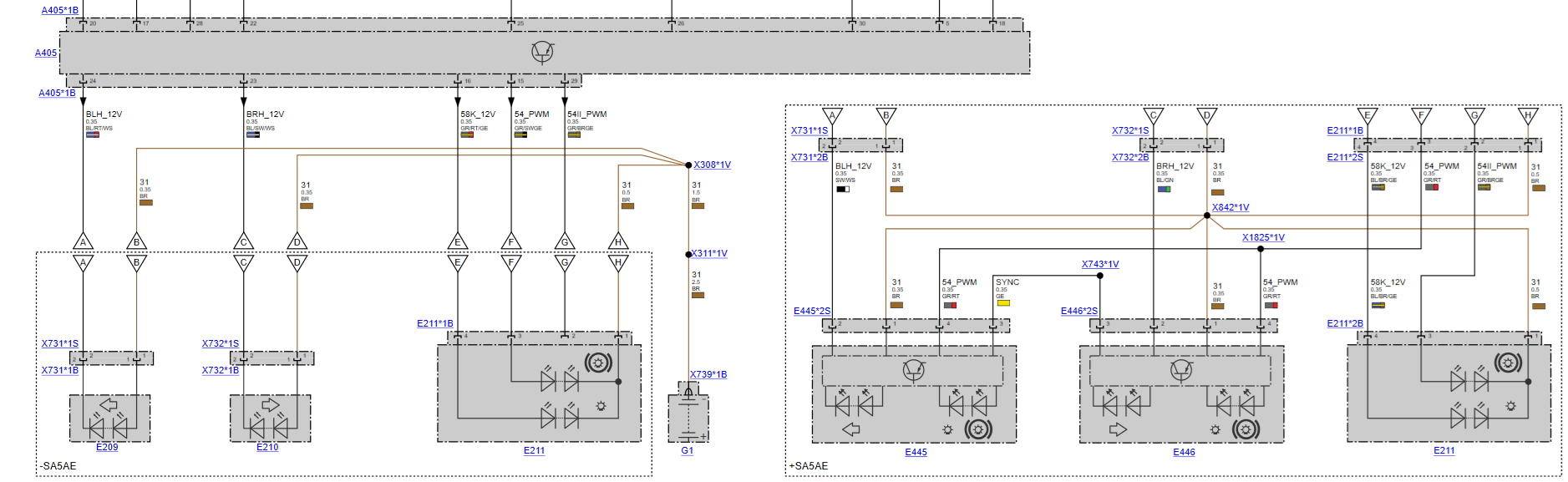

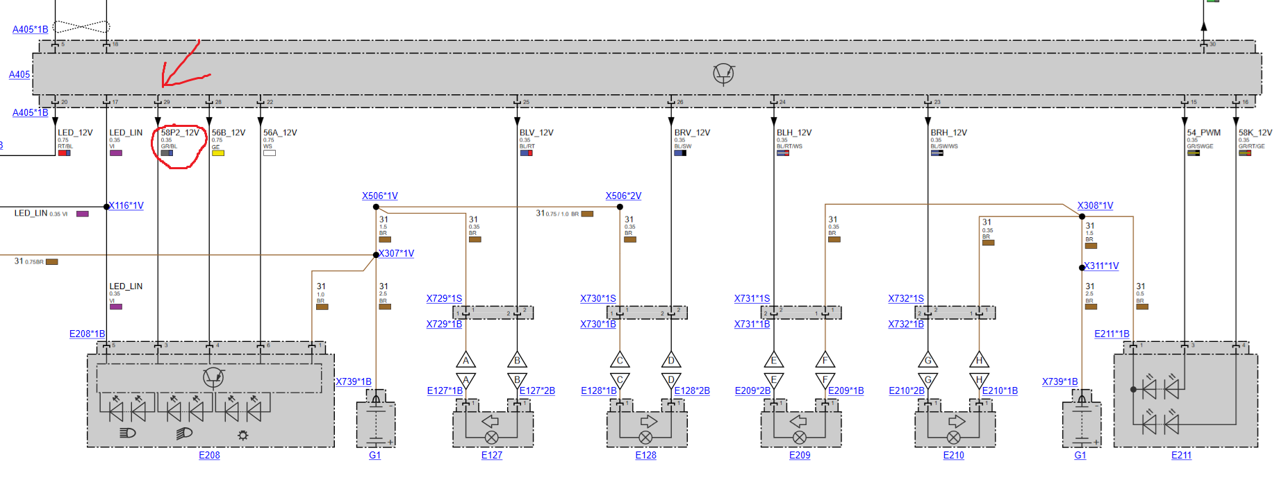

I can guess, being the thinner wire of three, and the other two being thicker, that pin 29 is position lights and the other two are low and high beam...
rinalds2m
rinalds2m
29.12.2024
60
Lettland
R1250GSA
Also ich shreibe auf english besser, weil es gehts fuer mich besser. ✌
The wire (grey/blue 0,35mm2) from Pin 29 BCO to Pin 3 in front light really is just a spare wire. It has no function what so ever! I guess it is designed for some future updates and retrofits. :cool:

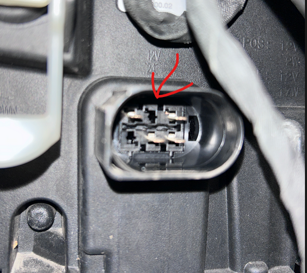

I went to garage, double checked my front light for right function and it works perfectly:
After that I removed the plug from front light and looked it over - There is no corresponding pin in the front headlight for the pin 3 in the plug!
So the question about what 58P2_12V does is solved. Nothing.
Few pictures in attachment for better understanding:
Conclusion... The retrofit and coding is safe and can be used without worries! ;)
