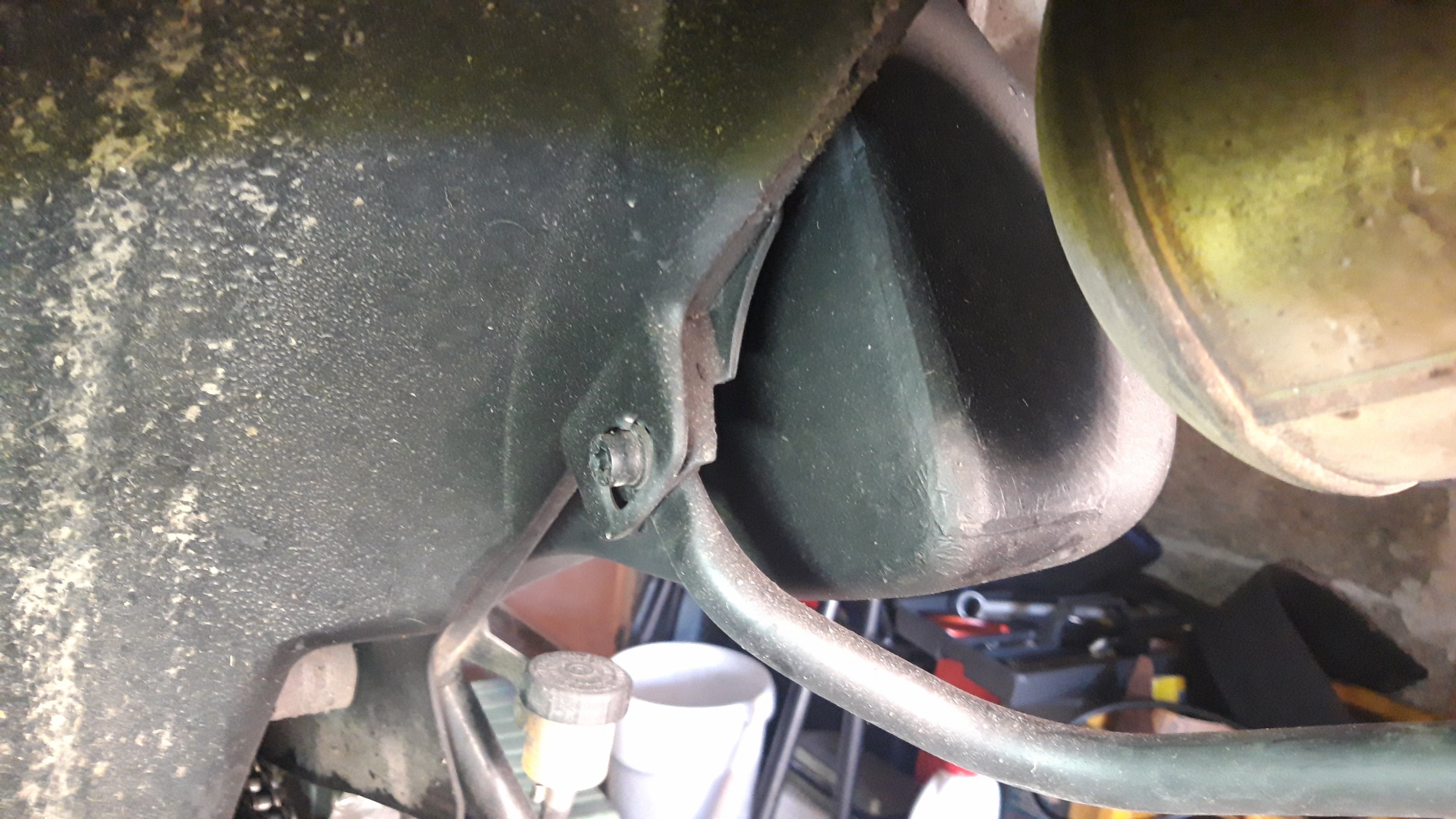

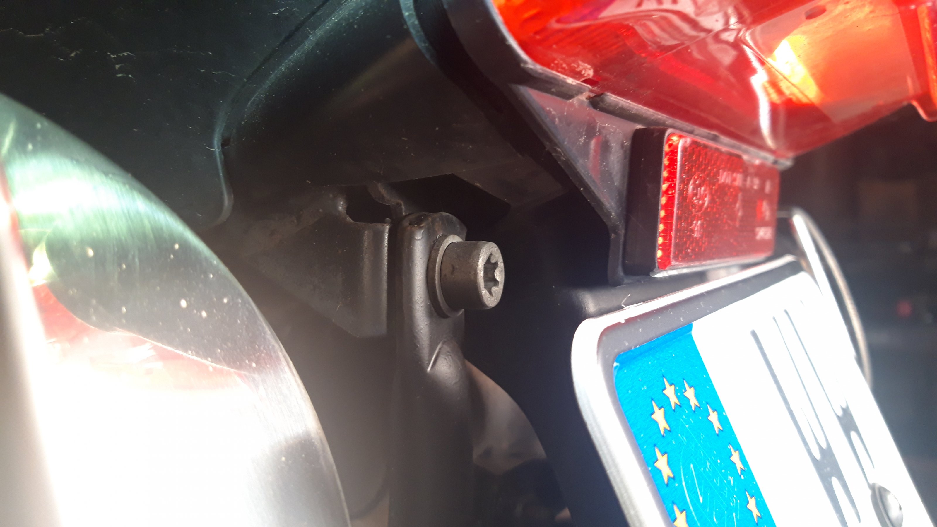

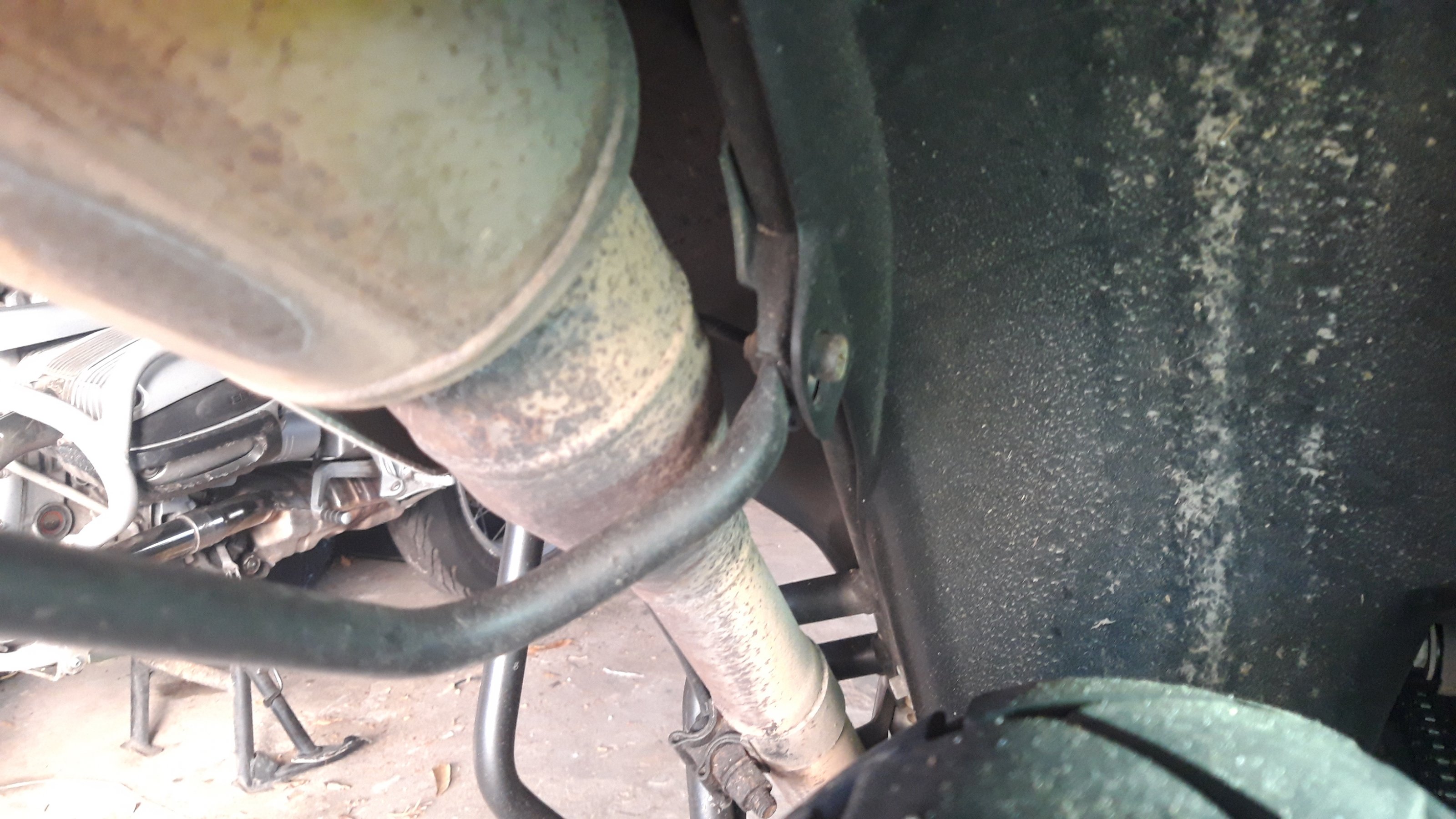

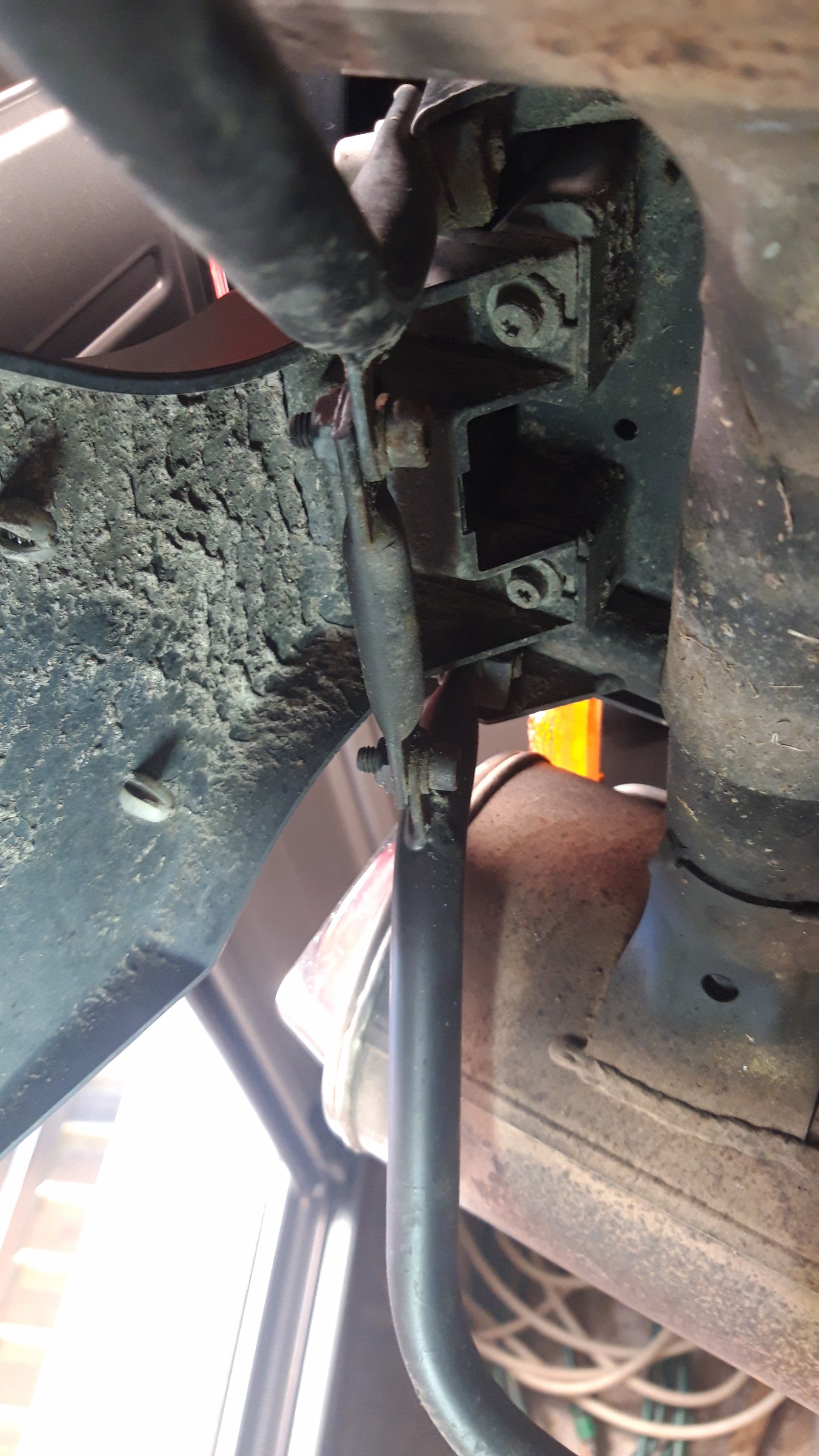

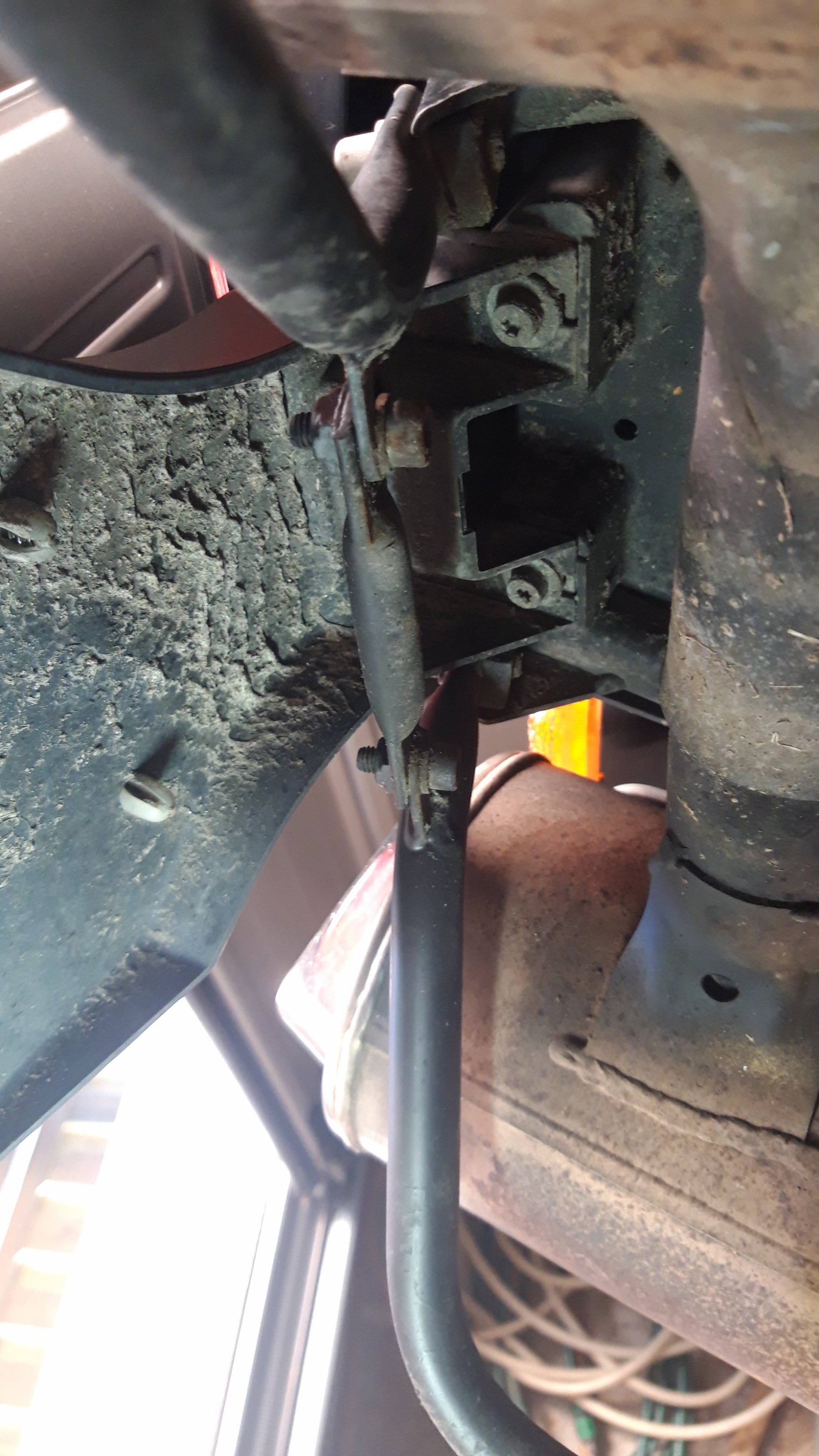

sigma
Joined
May 25, 2021
Messages
98
Location
Westerwald
R1150GS, F650GS Behörde, F650CS, Yamaha TW 125
Vorne links:
Vorne rechts:
Hinten:
