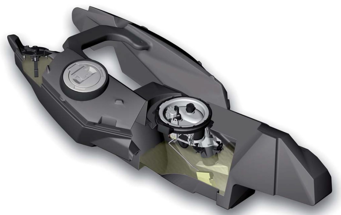

Due to the shape of the tank about half of the petrol is above the highest extension of the float. As a consequence the fuel gauge only starts to go down once the petrol level has gone down half a tank.

The remaining distance display works but it seems that many owners found it confusing (perhaps because of the gauge not registering until the tank is half empty). The remaining distance functionality is still present but on the 2011+ bikes it has to be activated using Motoscan or similar. Since the "reserve" is 4 litres the distance you can go is about 100 kms if you take it easy. Since the fuel pump is cooled by the petrol it is best to not run the tank too low and certainly not all the way to empty.
