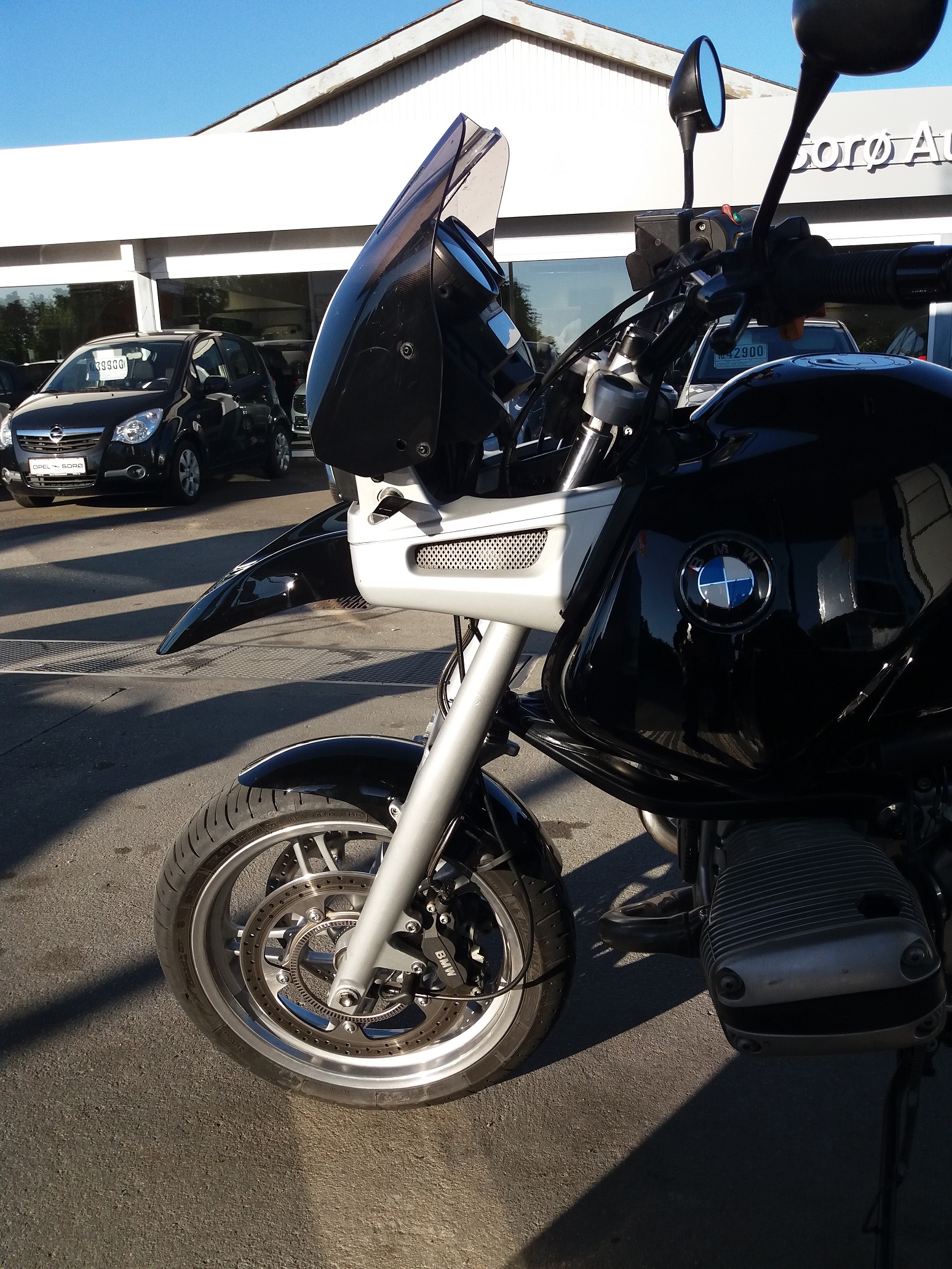

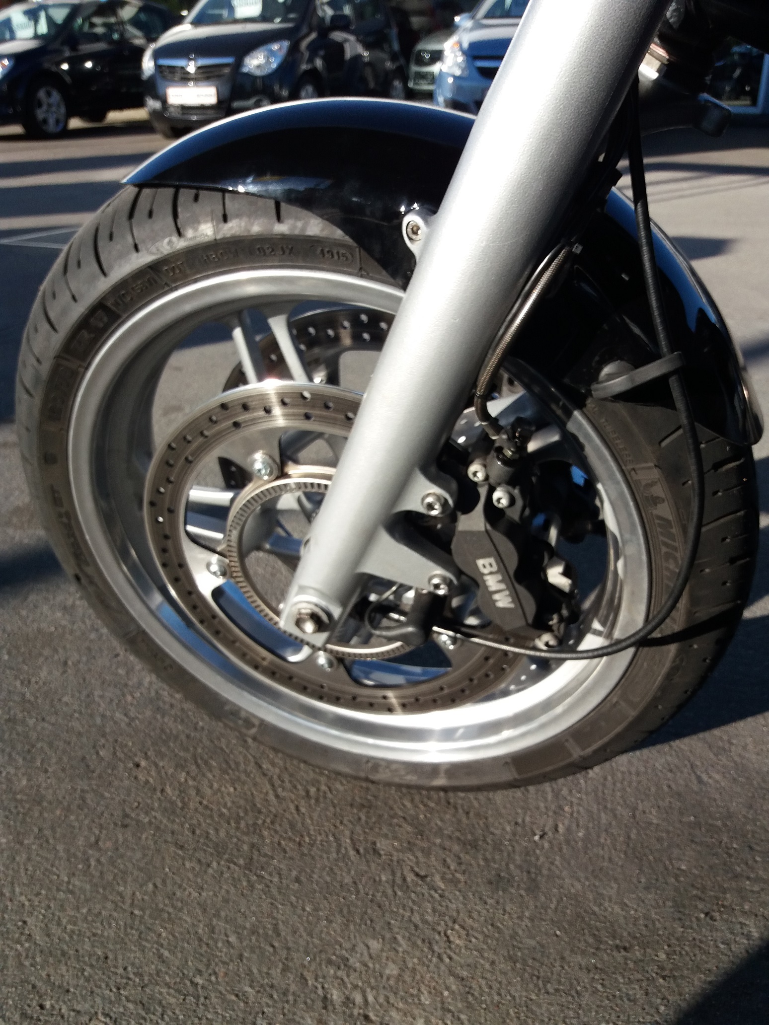

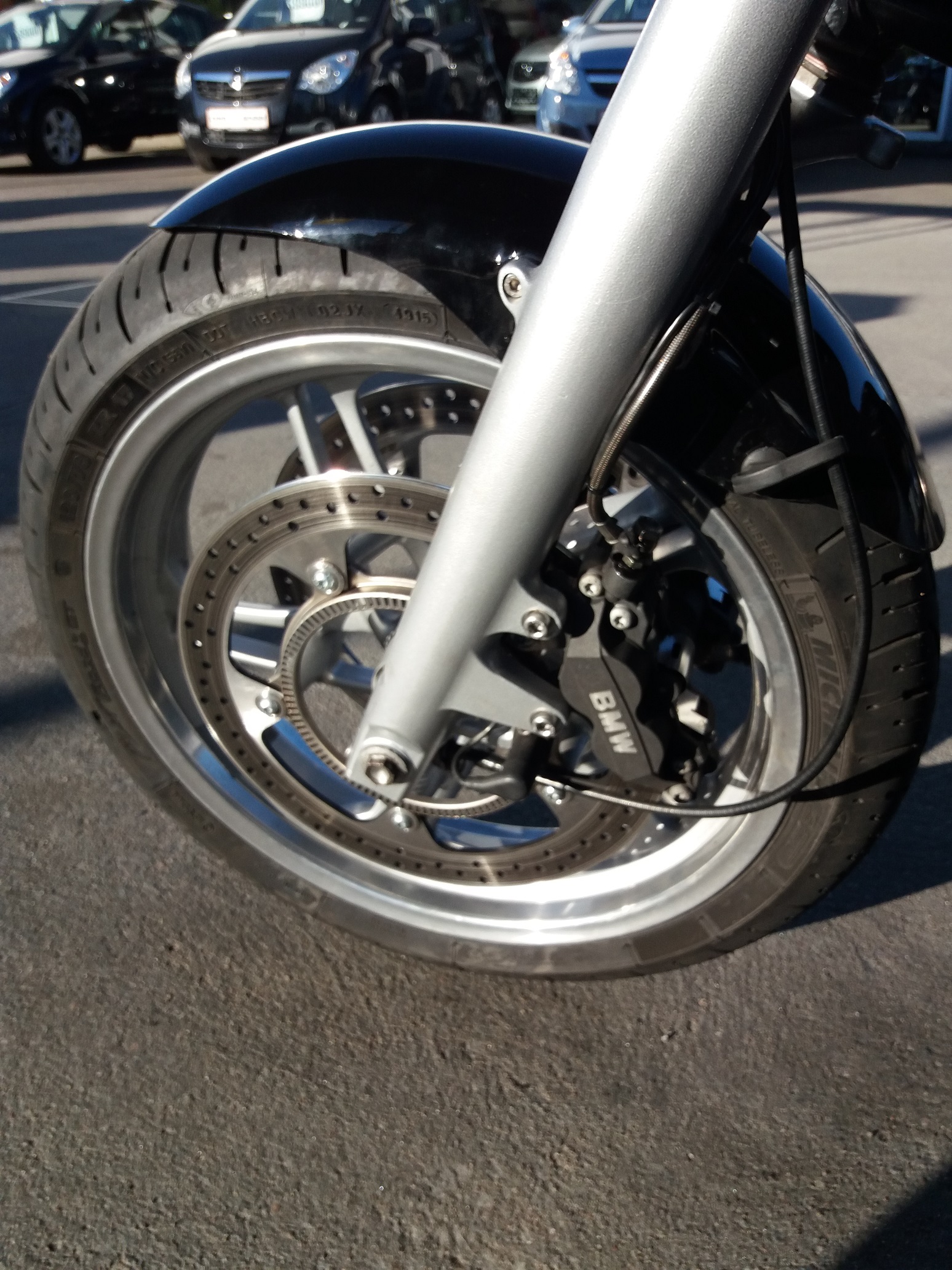

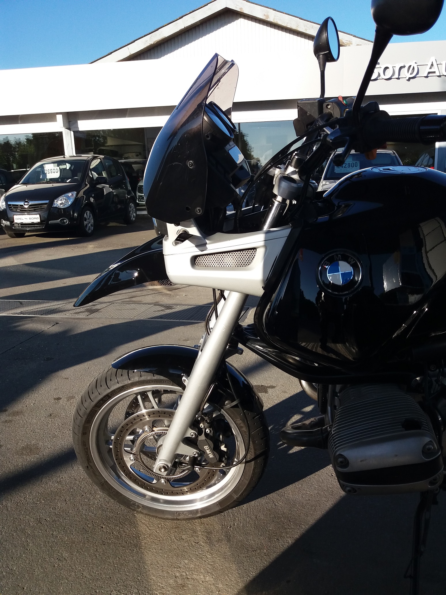

Now I have fitted a 1150R underpart on my 1100GS upperpart, it is just plug and play, so now I have 320mm discs in the front :DR bremser 2.jpg R bremser.jpg
