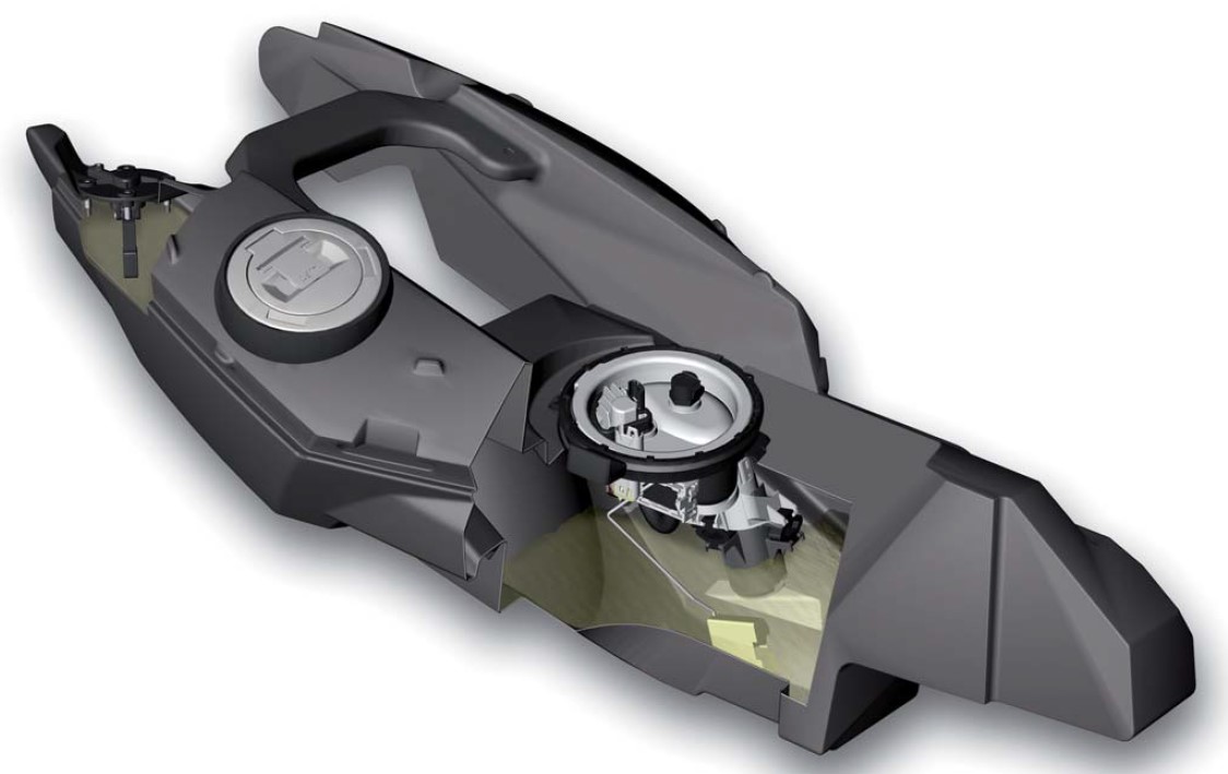

The top half of the tank cannot be sensed because the shape of the tank is such that the float sensor cannot measure it.
