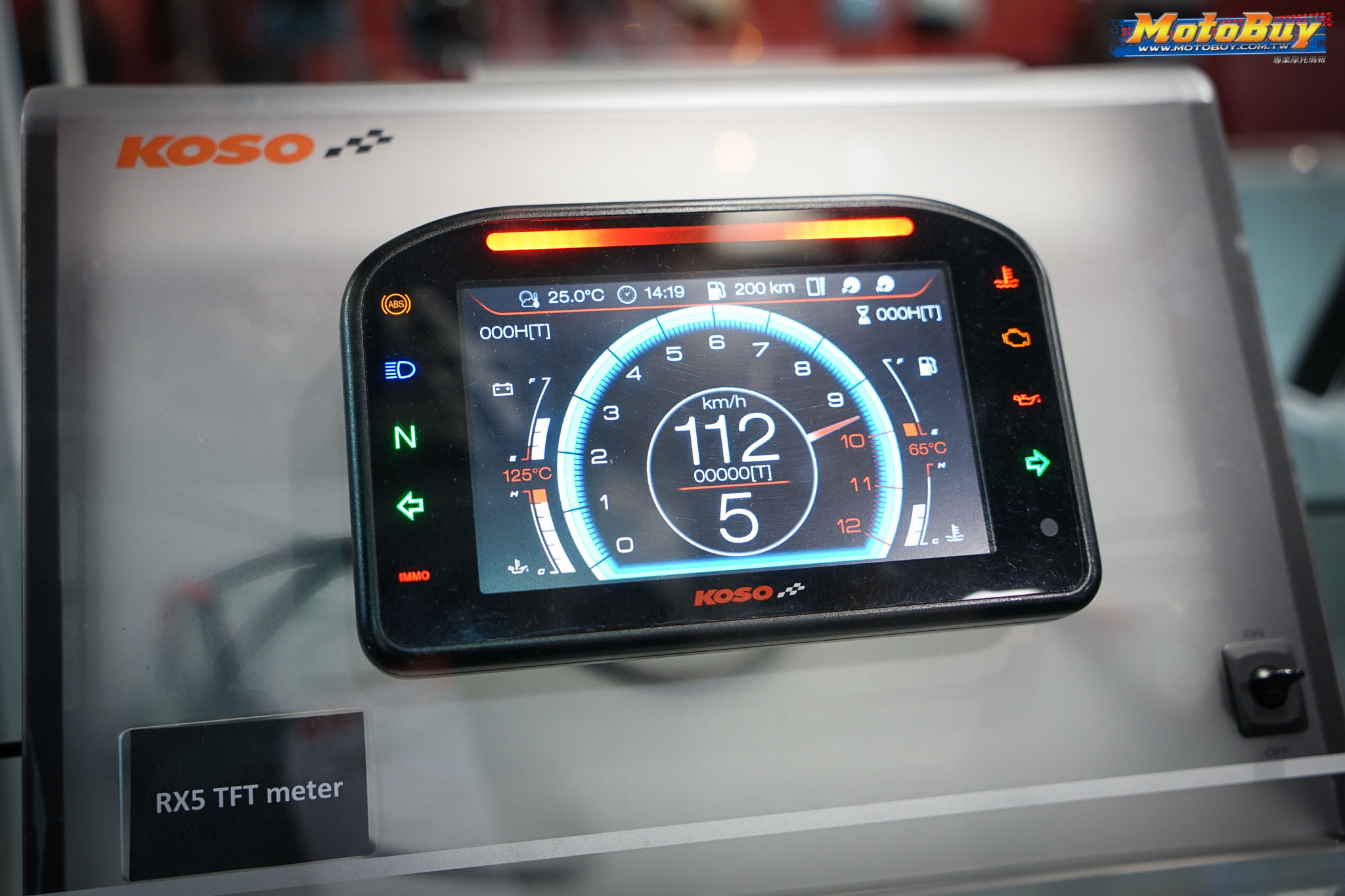

My RX-5 should be delivered within the next few days. In preparation, I've done a diagnostic scan with the GS-911 and the report showed No Faults. I also made a note of the Service Reminder mileage I created when I last changed the oil, the range based on my gas and the odometer to see if the Koso correctly shows this data after the install.

Installed the RX-5 today and completed a diagnostic scan. It's showing the same fault codes as it did when they recalled them. Two ABS faults and two Engine Controller faults all because the bike main computer does not recognize the RX-5 as the original display.
I'm also having some difficulty navigating through the different screens but that could be my problem. Not sure if I want to keep it or not yet.

The errors are not seen on the RX-5 display they are only shown during a diagnostic scan as is done when at the dealer. I completed a scan just prior to the RX-5 install the there were no Fault Codes in the system however immediately after the RX-5 was installed the scan showed the 4 Fault Codes. These are the identical codes that were present last year which prompted the recall. I can clear the codes however when the bike is restarted the fault codes are again shown.
I've sent an email to Koso with these concerns and would expect to hear something from them later today. A copy of the email went to their technician. I can also forward a pdf of the before and after scan I completed on the bike.

I didn't do a road test on the bike however last year during the initial release of the RX-5 another rider received these same faults on his bike. He did ride the bike and the ABS was still working despite the errors from the bike's main computer during a scan.
The problem is if you were to be involved in an accident and law enforcement or the insurance company did an inspection on the bike and found that there were these fault codes present on your bike I'm not sure they would say 'No problem' they are just errors that show up on a diagnostic scan.

Wenn ich das auf der verlinkten Seite richtig verstanden habe, ist das ein Prototyp der 2019 auf der Messe vorgestellt wurde.
